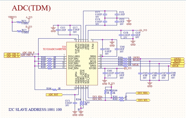

TLV320ADC5140 has a lot of noise, and the software is set to default. There are no issues with power ripple and noise. Is there a problem with the settings?
您好,
输入模拟信号是怎样的?输入模拟信号本身是否有噪声?
您差分输入为0的时候,输出噪声也很大吗?
MCLK输入频率多少?看下是否满足时钟输入要求:
[FAQ] TLV320ADC5140: MCLK Input Clock Requirements
另外,下面FAQ讲了音频ADC常见噪声问题,您可以对照检查下:
