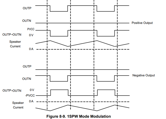

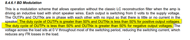

How to estimate and calculate the max duty cylce of PA output? (PVDD=24V)
TAS5828M has 3 modulation schemes: BD modulation, 1SPW modulation and Hybrid modulation.
BD modulation:
1SPW modulation
Hybrid modulation
