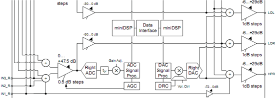

我想请问一下几个问题:
1.3254内部中的ADC处理模块和minidsp到底是什么关系,是并列的还是串行关系?还是ADC处理模块就是minidsp特殊情况下的部分?
2.minidsp的抽取因子该怎么理解,到底怎么使用?

手册上这样说:
The TLV320AIC3254 features two fully-programmable miniDSP cores that support application-specific algorithms in the record and/or the playback path of the device. The miniDSP cores are fully software controlled. Target algorithms are loaded into the device after power-up.
主要的意思是由软件控制的数据算法的处理器.
10.3.3.1.1 ADC Processing Blocks
The TLV320AIC3254 offers a range of processing blocks which implement various signal processing capabilities along with decimation filtering. These processing blocks give users the choice of how much and what type of signal processing they may use and which decimation filter is applied.
ADC处理模块则是数字信号滤波之类的硬件处理过程, 从下面的原理框图看, 也不是一个东西.
您好,非常感谢你的回答,我还想提出一些问题:
1.如果是分开独立的,那在CS软件中的ADC处理模块选项为什么只能选择minidsp或者预置ADC处理模块,而不是同时可以选择?是不是我的理解还有问题,谢谢
