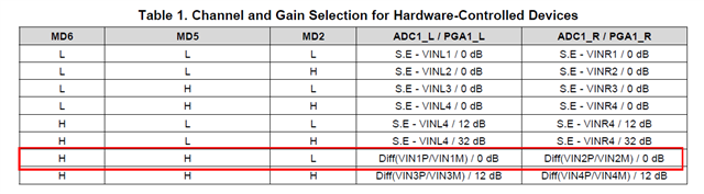

We found that when using PCM1860 and PCM5142, the output audio amplitude of PCM5142 decreased by half compared to the input audio amplitude when the output was set to 0dB. Both chips are set to I2S mode with 12.288MHz MCLK
For example, with a differential signal input of 1V vpp and PCM5142 set to 0dB output, the analog output amplitude of PCM5142 measured by an oscilloscope is 0.5V vpp
May I ask what caused it

    1_Confirm that if you put a full scale analog input at input of ADC, you get all ONEs at the output of the ADC for each channel  ( this is to make sure there is no attenuation set from ADC  ) Single-Ended, 2.1-VRMS
    2_ Similarly you can send a digital FS (All ONEs ) to the DAC, and see if you get FS or still FS/2? Similarly make sure there is no attenuation is set in DAC ( for example the DAC can has -6dB attenuation according to Table 3. Gain and Attenuation in Hardwired Mode). Also note that PCM514x provides 2.1-VRMS ground centered outputs
    Basically, you  need to confirm if there is an issue,   is it related to  the DAC side or ADC.
    It is important to confirm the above first.
    Once you confirmed there is no issue with the above items  , then we can move on to the following;
    1-Please share more information about the I2S signals. For example what is Fs and BCLK and channel depth.
    2-Confirm that the data format is indeed I2S  for BOTH  ADC and DAC ( both in register  set up and actual data send in to DAC ( if you format is not what it is supposed to be, MSB can be missed or move to LSB of the previous channel (LJ to I2S or I2S to LJ and things like this) Please screen  capture the I2S signal edges as depicted in Figure 16 of  DAC datasheet .
