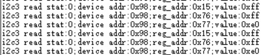

why PDMCK no signal out?
Part Number: PCMD3180
Other Parts Discussed in Thread: TLV320ADC3140
this is register read from PCMD3180
IC is working,but no PDMCLK out put and no PDMIN signal.
next is my register config.
# CHECKSUM 0
# Generated by ADCx140EVM-SW v3.0.5
# TLV320ADC3140 device configuration
# Reset
# Select Page 0
w 98 00 00
# Reset Device
w 98 01 01
# 1mS Delay
# Begin Device Memory
# Page 0 (0x00) Dump
# Select Page 0
w 98 00 00
# Wake up and enable AREG
w 98 02 81
# ASI Configuration
w 98 07 40
w 98 08 20
w 98 09 20
# Clock Error Disable/Enable
w 98 04 40
# GPIO Configuration
w 98 21 a2
# GPO Configuration
w 98 22 40
w 98 23 41
w 98 24 41
w 98 25 41
# GPI Configuration
w 98 2b 45
w 98 2c 67
w 98 32 04
w 98 33 3f
# Channel 1 configuration
w 98 3c 40
# Channel 2 configuration
w 98 41 40
# Channel 3 configuration
w 98 46 40
# Channel 4 configuration
w 98 4b 40
#DSP configuration
w 98 6c 28
# Channel Input/Output Configuration
w 98 73 ff
w 98 74 ff
w 98 1e 82
# M divider Enabled with Divider Value
w 98 1f c0
