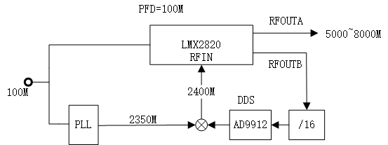

I changed the lmx2820 from normal mode to loopback mode,in the normal mode i locked to 6GHz, and when i changed to loopback mode,the frequency is stll 6GHz.
In the loopback mode ,i use a DDS as a external fractional-N divider,and i changed the frequency to 6005.999MHz,or other frequency near 6GHz,no more than ±50MHz,but the frequency did not change,still locked to 6GHz,
the LMX2820 register, i only changed  0xh220010  to  0x220810, and the DDS's FTW ( to change fractional  frequency ),  is there any other register i should configure
