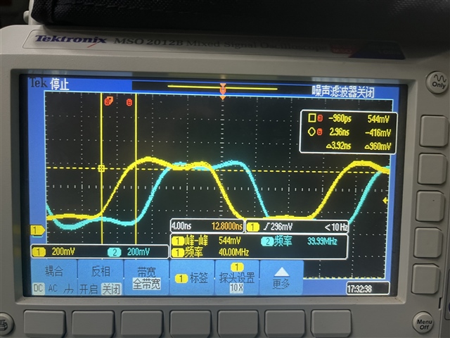

LMK04616: uncertain phase for LMK04616 on ZDM mode
Part Number: LMK04616
Hello,
  We are using LMK04616 on ZDM mode, but we found The phase relationship between the test output OUT0 and the OSCIN input is uncertain.
  Could we have some suggestion for repairing it?
Best regards,
Alex
  • 感谢您对TI产品的关注!
    已经收到了您的案例,调查需要些时间,感谢您的耐心等待.
  • Can you share your clock tree/configuration file? In order to have phase determinism between OSCin and the output, you need to feedback one of your outputs into the PLL2 N Divider.

  • Hi Vivian,
    Thanks for your help. But I still have a question.
    Only pll2 loop ZDM can be stably locked, but the phase difference between the 40M clock of OSCIN and the 40M clock of OUT0 is 4ns. Is this normal? We understand that after the ZDM is implemented, the phase difference between these two clocks should be 0ns. The yellow part in the following figure is the OSCIN clock, and the blue part is the clock of OUT0.
    Thank you again for your time.
  • This appears normal - ZDM does not imply that the phase difference between these two clocks will be 0ns, but it does imply that they will have a fixed relationship.
    Have you implemented a SYNC event? Technically speaking, ZDM only results in this deterministic relationship between OSCin and the fed back output (CLKout8 I beiieve?) until a SYNC event is triggered.
