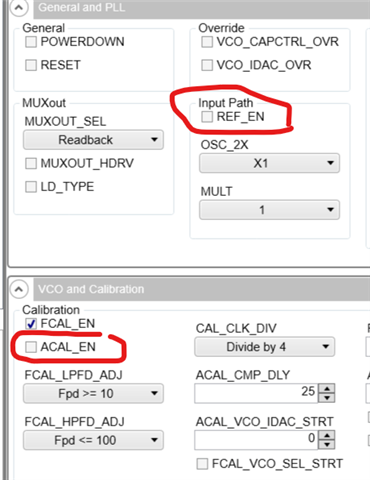

    There are couples of error in your configuration, the most serious errors are as follows:
    Please try below configurations.

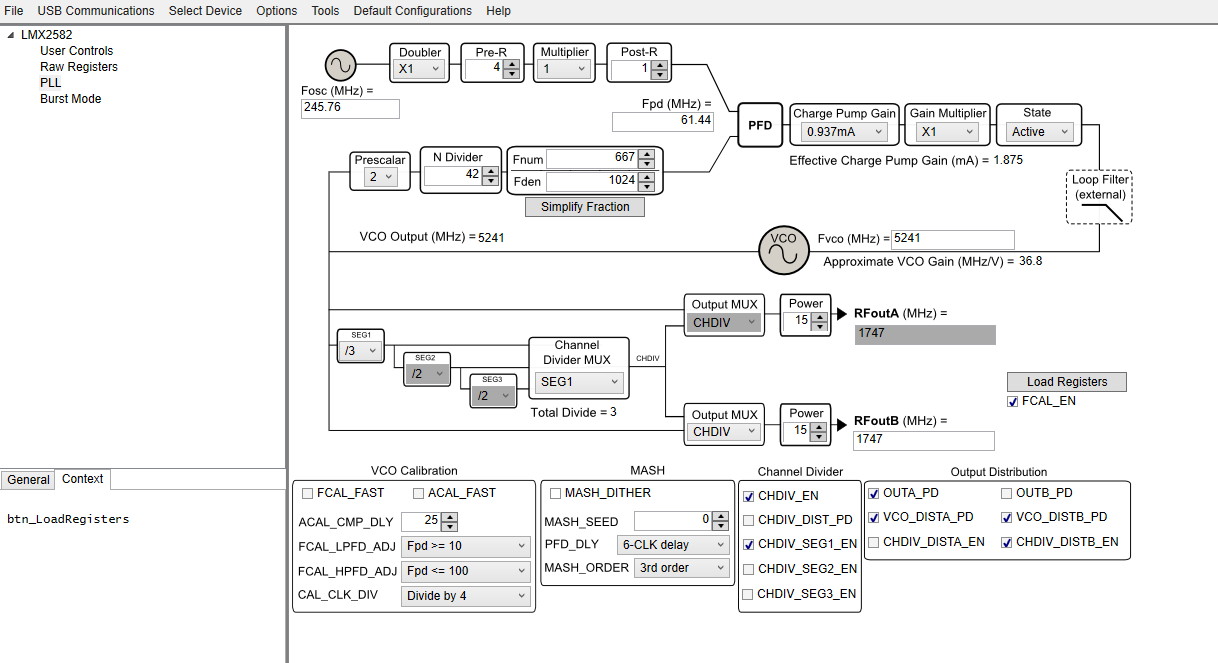

  • The signal output is now functioning normally using the provided configuration for verification. However, during testing, it was observed that the second harmonic signal is relatively high, with a level only 7 dBc below the fundamental signal. Could you please provide guidance on potential sources of this issue? Thank you.
