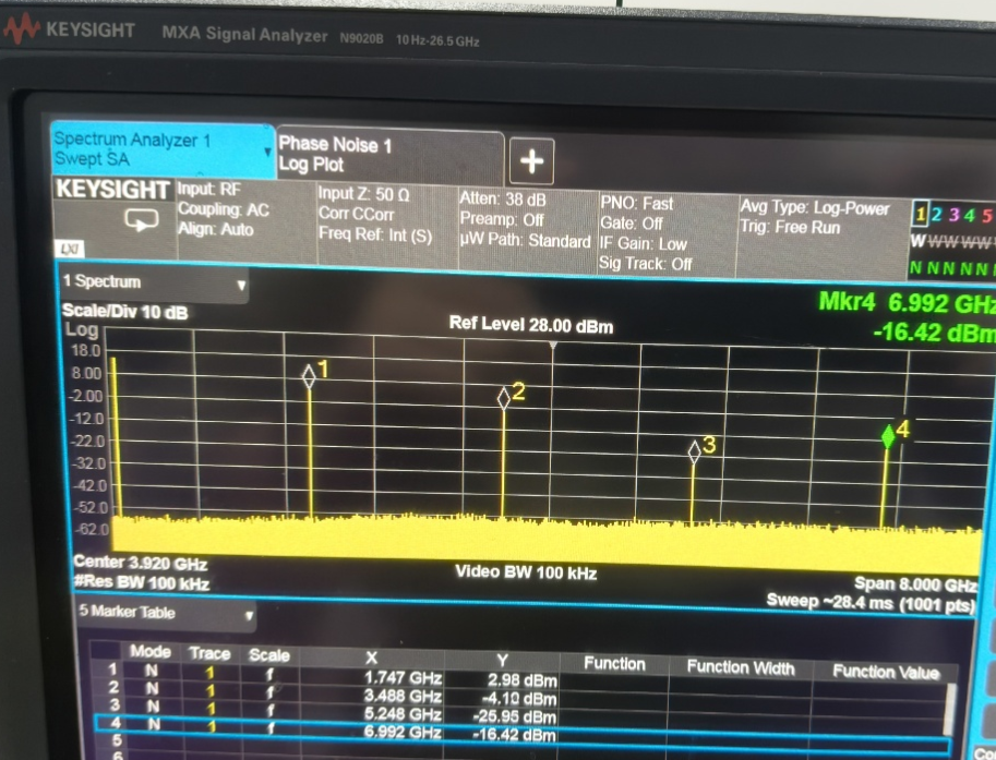

LMX2582: The second harmonic output generated by the LMX2582 is relatively high
Part Number: LMX2582
Currently, we are using LMX2582 on the board. During testing, it was observed that the second harmonic signal is relatively high, with a level only 7 dBc below the fundamental signal. Could you please provide guidance on potential sources of this issue? Thank you.
