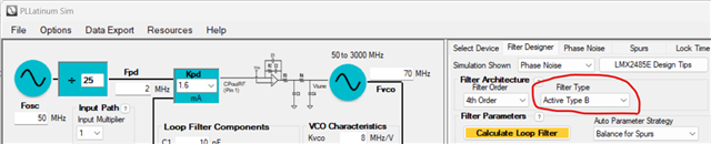

  • The matching between VCO and PLL is not important, as long as there is sufficient signal going back to the PLL, it is fine.
    If you are planning to use active loop filter, depending on your amplifier configuration, you may need to change the phase detector polarity, which is configurable. Low noise op-amp such as OPA211 is recommended.
    You can use PLL Sim (www.ti.com/.../PLLATINUMSIM-SW) to design the loop filter, active filter type B is my preference configuration as it requires less component.
    FYI, attached is the user's guide for one of the EVMs using active filter. However, we do not support EVM for this device anymore.

  • Hi Eirwen,
    Thank you so much for the detailed guidance! This clears up all my concerns regarding the discrete PLL implementation.
    I now have a clear path forward for the first stage design. Thank you again for your excellent support!
