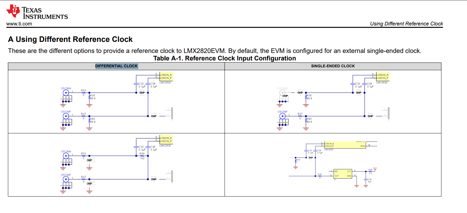

I have two questions regarding the section “A Using Different Reference Clock” in the LMX2820EVM design documentation:
Question 1:
The differential clock example does not include an external crystal oscillator (XO). Does this imply that the LMX2820 does not support or is not recommended for use with a differential crystal oscillator? If differential XOs are supported, could you please provide the relevant design specifications and implementation guidelines?
Question 2:

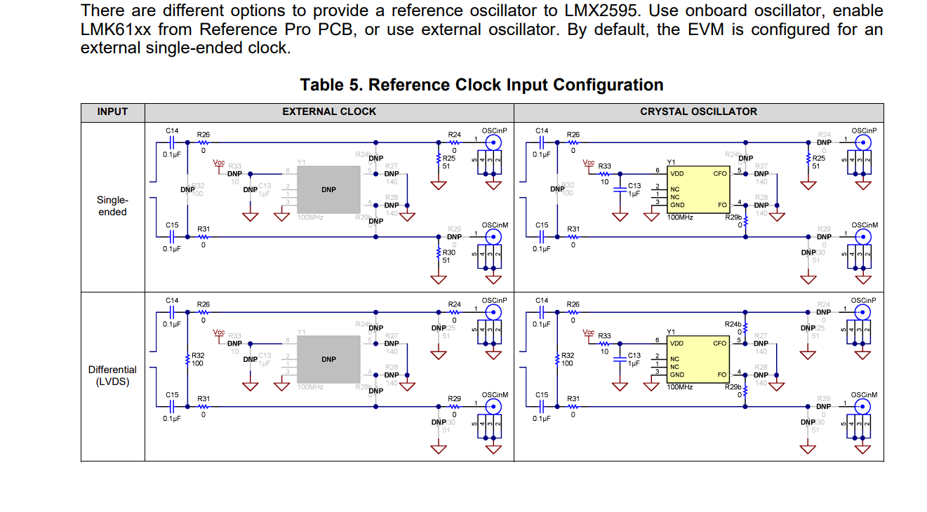

In the single‑ended clock example, when soldering crystal oscillator Y1, why is resistor R35 a 0‑ohm resistor connected to ground, rather than a 50‑ohm resistor? I have observed that in design manuals for other similar RF chips (e.g., the LMX2595, as shown in the attached figure), this resistor is typically 50 ohms.
