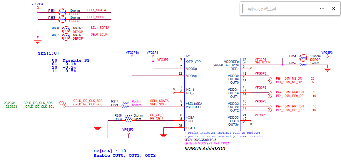

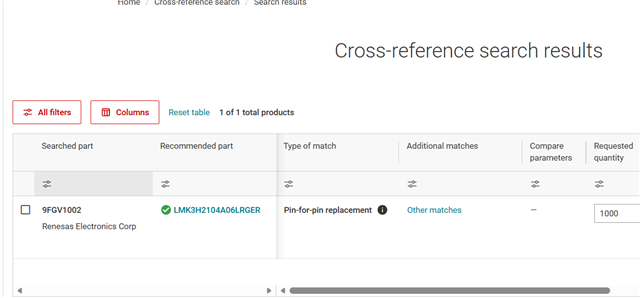

Hi All,
We are looking for alternative components for the following design and we found TI's LMK3H2104A06LRGER. According to the datasheet, PIN6 and PIN8(we don't use) of the TI part should be left floating if not used, but our design uses pull-up and pull-down. Is this acceptable? And also help me check if replacing the following design with TI would be okay?Thanks so much.image.png
