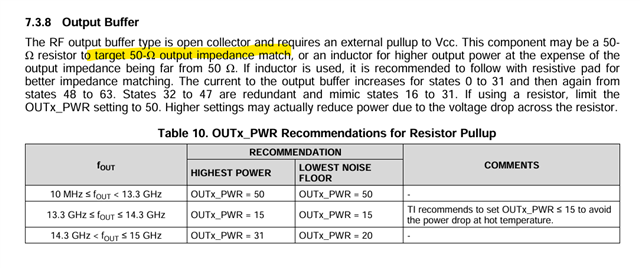

Hello,
One month ago, I asked one tech issue about LMX2594 chip RF output power.
Today, I have another tech issue during design the circuits according to the schematic of LMX2594 EVB board.
What's the RF output impedance of LMX2594 eval board?
thanks,
