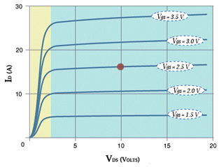

    LVCMOS output buffers are, as the name suggests, low-voltage complementary MOSFET outputs. This means that the output stage is derived from a P-channel and N-channel MOSFET in a "totem pole" configuration, see below.
    These MOSFETs have some intrinsic parasitic capacitances from gate to drain, gate to source, and source to drain, which vary as a function of applied VGS and VDS voltages. But these capacitances can easily be in the picofarad range in terms of order of magnitude.
    Additionally, each MOSFET has some maximum short-circuit current it can supply based on the gate-source potential that can be applied internally, where the MOSFET hits the linear region and begins to behave like a linear resistor. This might be a few tens of mA.
    In order to make for a convenient and approximately correct example calculation, let's say 5pF is the parasitic capacitance and 50mA is the short-circuit current achievable in the MOSFET linear region - this is reasonably close to the actual values for the LMK04832.
    Now, consider a 3.3V sine wave at 1GHz. Taking a basic derivative, we know the maximum slew rate of just this sine wave is 2π*Vpk*F, which at 1GHz works out to about 10V/ns. Incidentally, if we take 5pF and 50mA, and consider that I = C * dV/dT, we find that dV/dT = 50mA / 5pF = 10V/ns. Since our output current is limited by the drain-source voltage during the short circuit condition, our output slew rate can never be faster than what is required for a 3.3V 1GHz sine wave.
