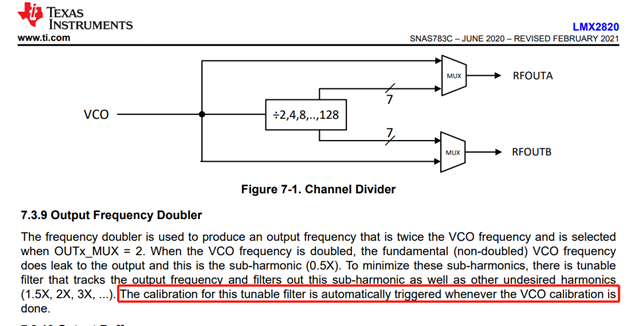

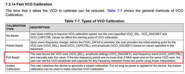

I have a question about Output Doubler calibration.
In Full Assist mode of VCO calibration type, there is no VCO calibration step, How to do Output Doubler calibration for frequency changing?

To do full assist with VCO doubler engaged involves read/write to a bunch of hidden registers. This operation is not recommended unless there is a very strong reason to do so.
What is reason to use full assist, instead of InstCal ?
