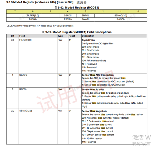

ADS1263: ADS1263设置200UA的偏置后,再读取ADC采集的电压,和实际有偏差
Part Number: ADS1263
使用如下图所示的寄存器进行采集偏置配置,配置为200ua。再对两路ADC引脚进采集,使用万用表查看给进ADC引脚的电压。和adc采集的电压相比并不一致。ADC引脚测出来为28mV,而adc采集测出的电压为98mV。这是为什么?采集偏置会影响到ADC采集数据吗?

  • 单纯采集功能是没问题的,但是我们想实现故障检测功能,使用偏置配置输出电流,外接电阻进行回环,测量电阻值,这个方案可行吗?
  • 您好
    Can you provide a block diagram of how the system is configured? I don't understand what the customer has connected to the inputs
    The sensor bias is intended to be used as open wire detection. If the connected sensor has a broken wire, the sensor bias will pull the inputs to the supplies, resulting in a full-scale code. This feature is not intended to be a precision current source; instead, use the current DACs (IDACs) for a higher precision source that is intended to be used in ratiometric measurements
