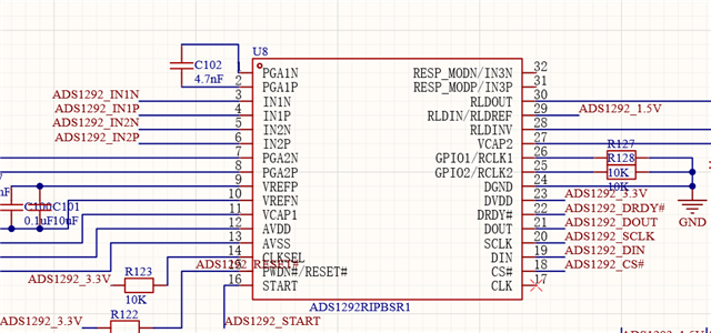

ADS1292: About How to do with RESP Pin/IN3N IN3P if I do not want to use them.
Thank you for contacting TI China E2E forum and choosing our products as part of your solution. Regarding your query, you can connect unused analog inputs to AVDD.
