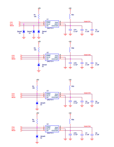

Hi,
I have some problems using DAC7311.
(1) When the MCU sends different SPI data to U1 of the circuit diagram, SPI CLK=1MHz, SPI data D11~D0: 6EF(hex)~611(hex),the data decreases every 14(hex). Normally, Vout-CH1 will decrease with the data decrease, and the output voltage will also decrease. However, during the data decrease process, the output voltage will occasionally drop to 0.4V, and after 20ms, it will rise back to the normal output voltage. 0.4V is an abnormal output voltage range.
(2) When the same SPI data is sent to U2, U3 and U4 of the circuit diagram, the above (1) situation will not occur.
(3) I checked the SPI data and found no abnormality. I also observed it with an oscilloscope and the level and timing are normal. Could you please tell me where else I can find the problem?
Thank you!

  • 只有U1有问题,其他通道正常,这说明问题可能在U1及其周边电路的硬件层面​​。既然U2-U4工作正常,说明原理图设计、SPI通信协议和MCU驱动程序基本没有问题。
    建议从以下方面排查
    1.去耦电容是否电容焊接不良,短路,开路,或者容值是否有严重偏差
    2.U1芯片可能本身是否存在问题,可以交换U1和U2的芯片等验证
    3.通过示波器验证电源VDD的稳定性
