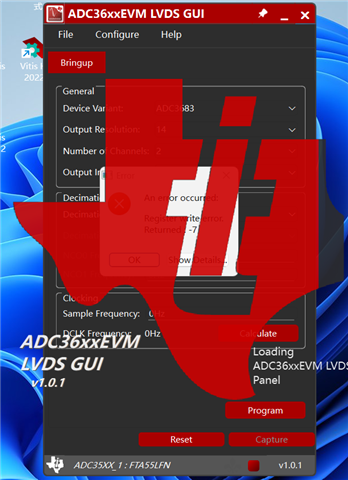

连接ADC3664EVM,打开ADC36xx-LVDS-EVM-GUI,显示Register write error
Can you please send us a pic of the ADC EVM you are trying to use with the GUI?
I believe you have older HW that does not work with the new HW we are about to release.

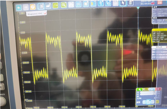

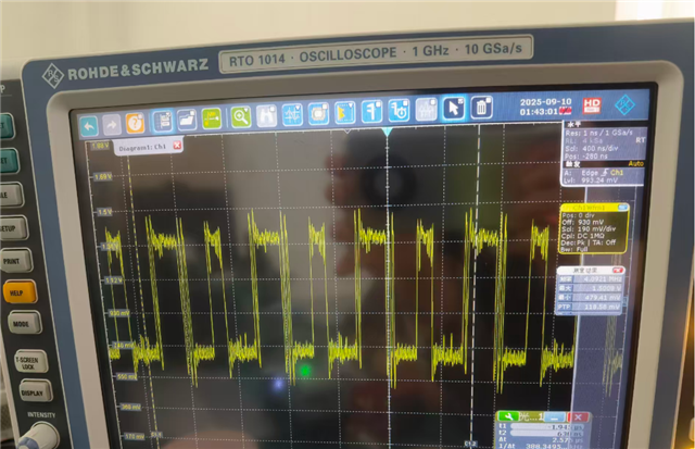

I use the "ADC35xx EVM GUI",the registers can be set now. But I encounter another problem, when I enable the DDC mode. When I use the bypass mode, the FCLK is correct, when I enable the DDC mode, the FCLK is error.
bypass mode
DDC mode

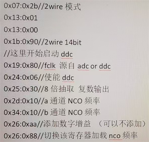

This is my registers set value and order
Please share the resolution, sample rate, number of wires, decimation mode, decimation factor, and provided DCLK frequency that you are using so that I can confirm the above configuration is correct.
