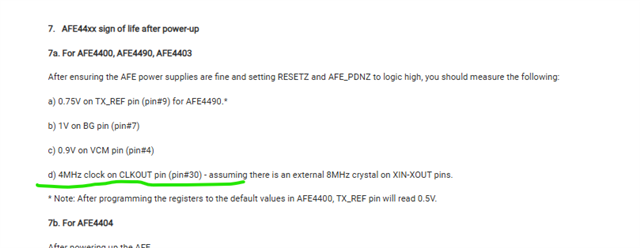

I would like to know what the CLKOUT waveform of the AFE4490 looks like.
Part Number: AFE4490
参考下方FAQ的7. AFE44xx sign of life after power-up
