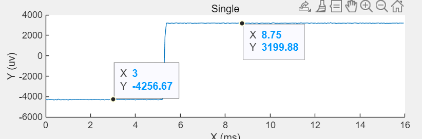

when I set the conf register to 0xd5, the ch1 register to 0x05, using internal reference. The signal's amplitude is around 7.5 mV, which is not the same as 2x-(Vrefp-VrefN)/2400 in the datasheet.

Thank you for your post. You are observing the correct signal amplitude. The amplitude is calculated as:
Amplitude (V) = 4.5V / 2400 = 0.001875, or 1.875mV. For 2x setting (CAL_AMP = 1), the amplitude will be 3.75mV, which is the same as 7.5mV peak-to-peak.
