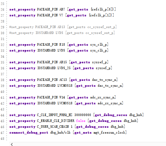

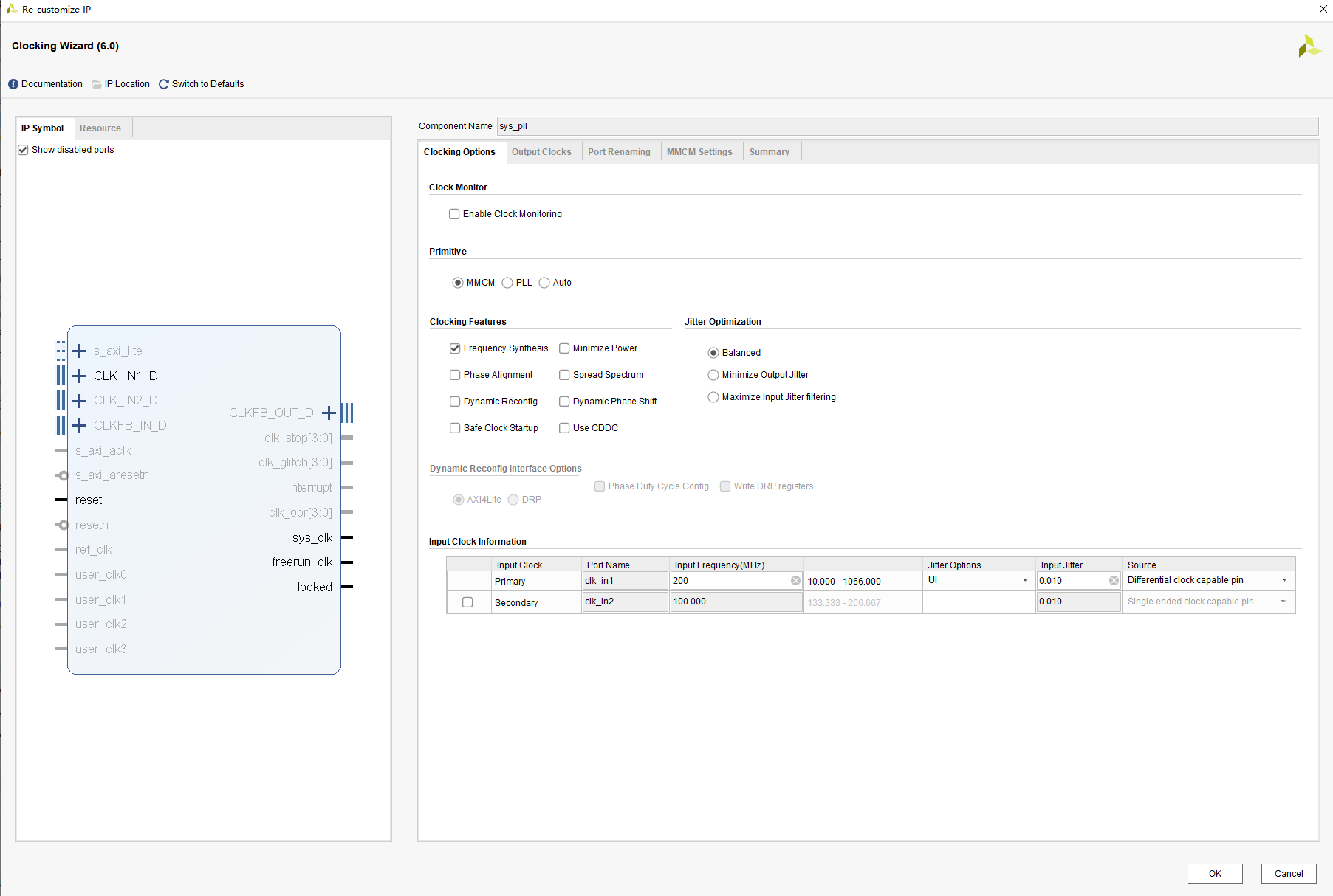

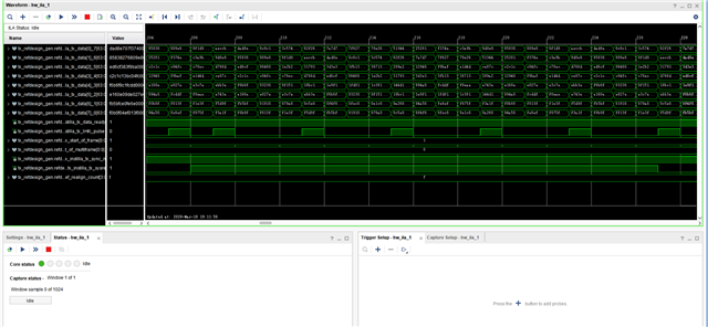

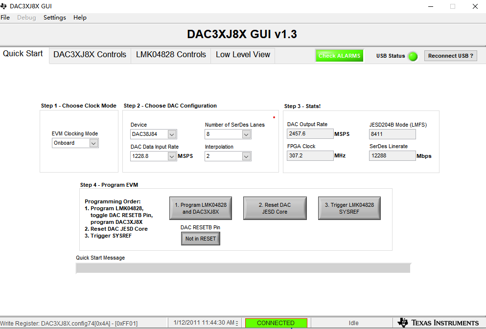

由于HIGH SPEED GUI不支持TSW14J58EVM+DAC38J84EVM,因此申请了TI-JESD204-IP。按照guide,进行了相关参数设置,但是DAC输出存在问题。想问一下是哪里出了问题,或者是否有任何可以参考的设计资料。    同时DAC38J84 GUI相关配置是否需要更改?dacgui.png PLL.pngxdc.png       以下为一些截图和配置代码,希望能对问题的解答有所帮助。
`undef IP_8B10B
`undef IP_64B66B
`define IP_8B10B
`undef IP_TYPE
`define IP_TYPE "TX"
`undef ADC_RESOLUTION
`define ADC_RESOLUTION 16
`undef DAC_RESOLUTION
`define DAC_RESOLUTION 16
`undef NUMBER_OF_RX_LANES
`undef NUMBER_OF_TX_LANES
`define NUMBER_OF_RX_LANES 8
`define NUMBER_OF_TX_LANES 8
`undef NUMBER_OF_QUADS
`define NUMBER_OF_QUADS 2
`undef MGT_TYPE
`define MGT_TYPE "GTYP"
`undef NUMBER_OF_REFCLK_BUFFERS
`define NUMBER_OF_REFCLK_BUFFERS 2
`undef LANE_ADC_TO_GT_MAP
`define LANE_ADC_TO_GT_MAP {3'd7,3'd6,3'd5,3'd4,3'd3,3'd2,3'd1,3'd0}
`undef LANE_DAC_TO_GT_MAP
`define LANE_DAC_TO_GT_MAP {3'd7,3'd6,3'd5,3'd4,3'd3,3'd2,3'd1,3'd0}
`undef RX_LANE_POLARITY
`define RX_LANE_POLARITY 8'b00000000
`undef TX_LANE_POLARITY
`define TX_LANE_POLARITY 8'b00000000
`undef RX_LANE_DATA_WIDTH
`define RX_LANE_DATA_WIDTH 64
`undef TX_LANE_DATA_WIDTH
`define TX_LANE_DATA_WIDTH 64
`undef RX_F_VAL
`define RX_F_VAL 1
`undef TX_F_VAL
`define TX_F_VAL 1
`undef RX_K_VAL
`define RX_K_VAL 32
`undef TX_K_VAL
`define TX_K_VAL 32
`undef RX_E_VAL
`define RX_E_VAL 1
`undef TX_E_VAL
`define TX_E_VAL 1
`undef RBD_COUNT_WIDTH
`define RBD_COUNT_WIDTH 10`undef RX_BUFFER
`define RX_BUFFER "NORM"
`undef BUFFER_RATIO
`define BUFFER_RATIO 1
`undef TX_BUFFER
`define TX_BUFFER "NORM"
`undef SYSREF_GEN
`define SYSREF_GEN
`undef SYSREF_TARGET_COUNT
`define SYSREF_TARGET_COUNT 8
