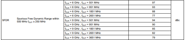

    We have planned to use the DAC38RF82 In our design with below configuration.
Fsample         : 8400MHz
Fout                : 275-475MHz (Bw:200MHz) in both channels
Interpolation : 6x
NCO                : 375MHz
Throughput/lane : 7000MSPS(L=8)
what will be expected SFDR for this output. In datasheet SFDR is only provided above 500MHz. We have also used the same front end circuit with same transformer as in the evaluation board (TCM3-452X-1+) which supports low frequency from 20MHz.
Could you please share us the spurious data for this frequency range.
Also what will be the spur power levels for these frequencies which will help us filter out in the output front end.
