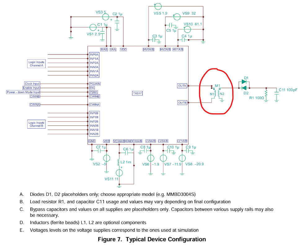

您好,
关于输出变压器,这两个帖子都有相关讨论,您可以看看能否参考,
https://e2e.ti.com/support/logic-group/logic---internal/f/logic---internal-forum/191501/tx517-question?tisearch=e2e-sitesearch&keymatch=TX517%25252525252520TRANSFORMER#
e2e.ti.com/.../2832538
