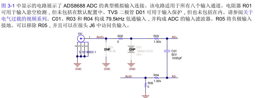

If C01 is grounded, with a cutoff frequency of 160 kHz, why does C01, connected across the differential signal, form a 79.5 kHz low-pass input—exactly half of 160 kHz?
您好,
请参考链接帖子内容,差分滤波的截止频率=1/2*π*C*(2*RFILTER)
