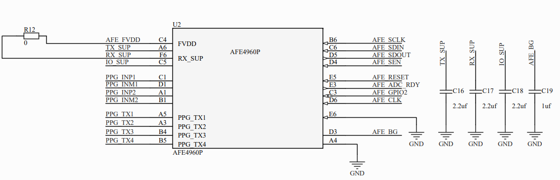

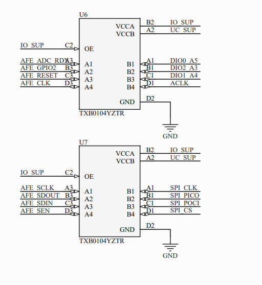

AFE4960P: 通过CC2340R53连接AFE4960P问题
Part Number: AFE4960P
Other Parts Discussed in Thread: CC2340R5
