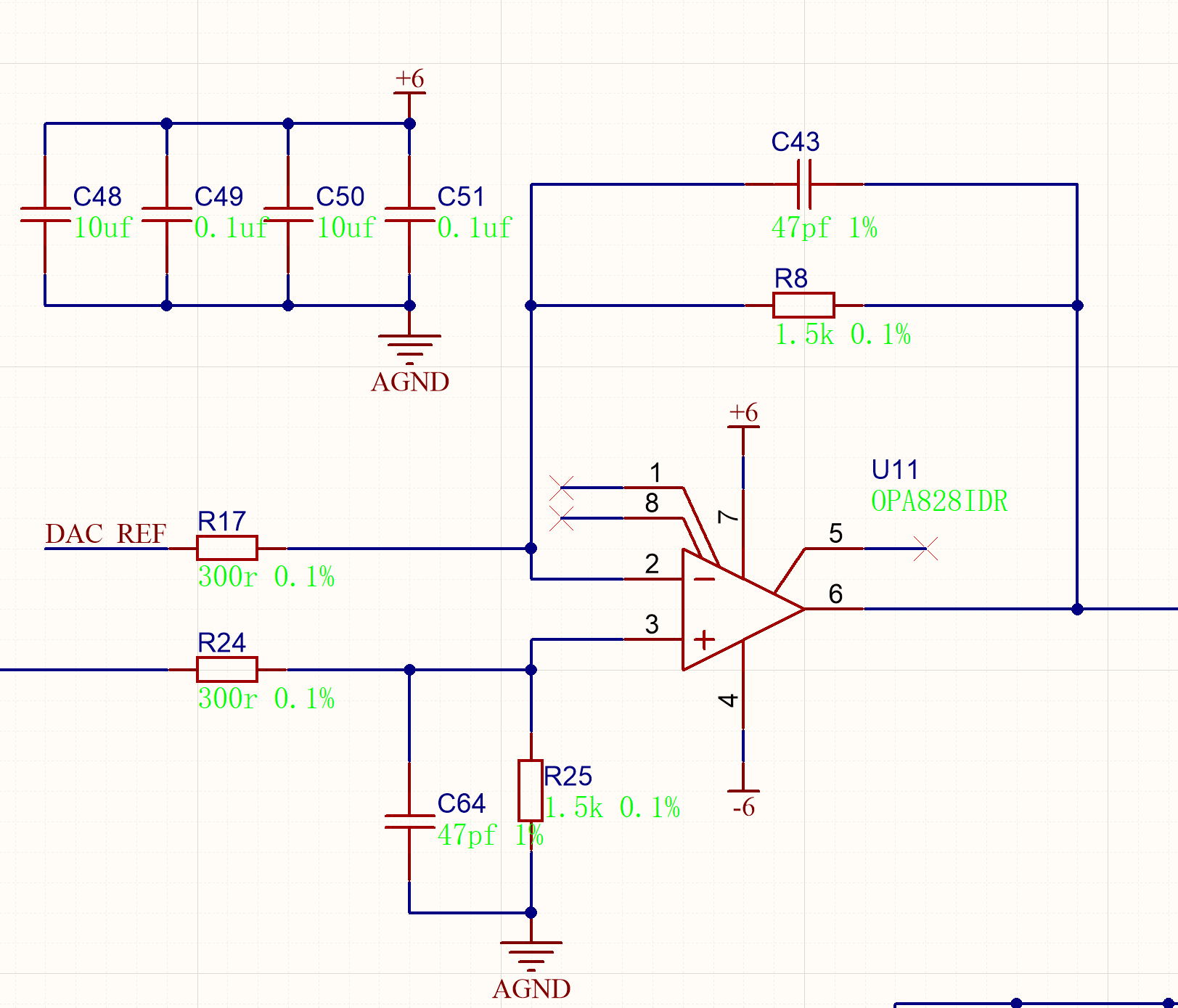

I am designing a high-precision analog front-end for measuring small voltage variations. The system includes an instrumentation amplifier, a DAC-based dynamic offset cancellation stage, a fixed-gain difference amplifier, a programmable gain stage, and a high-speed SAR ADC.
The issue I am seeing is that once the DAC offset path is connected to the fixed-gain difference amplifier, the input-referred RMS noise increases from a few µV to about 30–40 µV RMS. More interestingly, even when the inputs of the DAC offset amplifier are both tied to AGND, so that its output should ideally be 0 V, the noise is still almost the same as when the full DAC offset circuit is connected.
1. System structure
The measured signal first goes through an instrumentation amplifier and is converted to a single-ended signal. It then enters a fixed-gain difference amplifier, which implements:
Vout = 5 × (Vsignal - VDAC_bias)
The fixed difference amplifier currently uses a high-speed, low-noise op amp. The resistor values are:
Input resistors: 300 Ω
Feedback / reference-side resistors: 1.5 kΩ
Gain: 5 V/V
After this stage, there is a non-inverting PGA with gain settings:
1 / 2 / 4 / 8
Therefore, the total analog gains are:
5 / 10 / 20 / 40
All noise data below is input-referred RMS noise, calculated after dividing by the corresponding total analog gain.

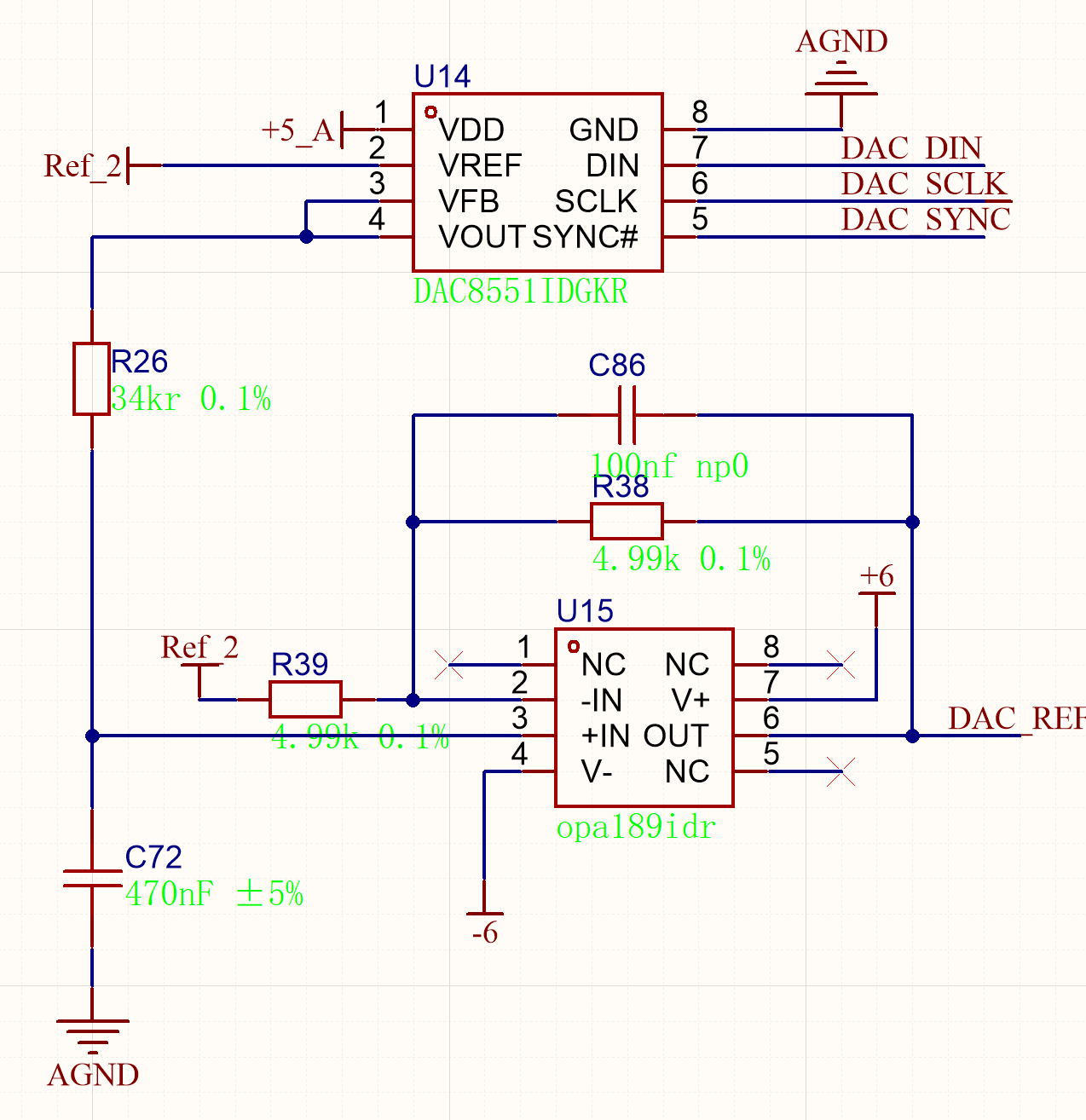

2. DAC offset circuit
The DAC offset path is used to generate a bipolar offset voltage, so that the DC component of the measured signal can be subtracted before further amplification.
The offset circuit is:
2.048 V precision reference → DAC8551 reference
DAC8551 output → 34 kΩ + 470 nF RC low-pass filter → non-inverting input of offset op amp
2.048 V precision reference → 5 kΩ → inverting input of offset op amp
offset op amp output → 5 kΩ → inverting input of offset op amp
Therefore, the low-frequency transfer function is:
VDAC_bias = 2 × VDAC - 2.048 V
When the DAC output is 1.024 V, the offset amplifier output should be approximately 0 V.
I have tried both OPA189 and OPA828 as the offset amplifier, but the noise level did not change significantly. I also tried different capacitors in parallel with the 5 kΩ feedback resistor, such as 10 nF and 330 pF, but there was no fundamental improvement.

3.3 Offset amplifier inputs tied to AGND, but output still connected
In this test:
The non-inverting input of the offset amplifier is tied to AGND.
The 5 kΩ resistor that normally connects the 2.048 V reference to the inverting input is also tied to AGND instead of 2.048 V.
The 5 kΩ feedback resistor remains connected.
The offset amplifier output is still connected to the fixed 5× difference amplifier.
In this condition, the offset amplifier should ideally output 0 V.
However, the measured noise is:
1 MSPS:
3.88E-05 3.94E-05 3.52E-05 3.47E-05
2 MSPS, average every 2 samples:
3.41E-05 3.38E-05 3.31E-05 3.08E-05
This result is almost the same as when the full DAC offset circuit is connected.
Therefore, the noise does not seem to come mainly from the DAC8551 output code itself, nor only from the 2.048 V reference. Even when the offset amplifier inputs are both grounded and the expected output is 0 V, connecting this active 0 V output to the difference amplifier still brings the noise back to the 30–40 µV RMS level.

I also tried removing the cable and shorting Sense+ and Sense− directly at the input connector of the board. As long as the DAC offset amplifier output is connected to the fixed difference amplifier, the noise remains much higher than when the DAC offset path is disconnected.
I also tried splitting the original 300 Ω DAC-bias input resistor of the fixed difference amplifier into:
DAC offset op amp output → 100 Ω → middle node → 200 Ω → difference amplifier input
Then I added a capacitor from the middle node to AGND. However, the noise increased by about 10–20 µV. After removing this capacitor, the noise returned to the original 30–40 µV RMS level.
So this middle-node capacitor did not help. It may have introduced AGND noise or parasitic effects from the temporary wiring.

  4. The 5 kΩ / 5 kΩ feedback network of the offset amplifier may have too high an impedance, making the inverting node sensitive to parasitic coupling and noise.
6. Planned modification
I am planning to reduce the two 5 kΩ resistors in the DAC offset amplifier to 2.2 kΩ:
Feedback resistor = 2.2 kΩ
Reference input resistor = 2.2 kΩ
Feedback capacitor ≈ 10 nF
This should still keep the same transfer function:
but with a lower impedance at the inverting node, which may reduce thermal noise and sensitivity to parasitic coupling.
7. Questions
  1. In this type of circuit, can the noise increase from a few µV RMS to 30–40 µV RMS simply because an active DAC offset source is connected to the difference amplifier?
  2. Could the 300 Ω DAC-bias input resistor of the difference amplifier be too low for the DAC offset amplifier, causing output noise, supply noise, or stability issues to be injected into the following stage?
  3. For this kind of structure:
should the DAC offset source be designed as a lower-output-impedance and lower-bandwidth precision bias source?
  1. Is reducing the offset amplifier resistor pair from 5 kΩ / 5 kΩ to 2.2 kΩ / 2.2 kΩ a reasonable direction for reducing noise and parasitic sensitivity?

  • Thank you for your attention to TI products. We are verifying your issue, please wait for our reply.
  • 1.Yes, absolutely. The offset amplifier contributes:
    • Voltage noise: 10 µV × noise gain 6 = 60 µV output → 12 µV input-referred
    • PSRR coupling: ~10 µV
    • Stability peaking: +3-6 dB amplification
    • Total: 20-35 µV, which matches your measurement
    2. Yes, for ultra-low-noise applications.
    300Ω is considered a heavy load for most precision op-amps:
    • Increases quiescent current → more shot noise
    • Reduces loop gain → worse PSRR
    • Can cause stability issues with capacitive loads
    • Output stage noise becomes more visible
    Best practice: Buffer heavy loads or increase to ≥1kΩ.

    4. Yes, it's beneficial but not sufficient:
    • White check mark Reduces thermal noise by ~30%
    • White check mark Lowers impedance → less sensitive to coupling
    • White check mark Improves settling time
    • X But doesn't solve the fundamental problem (output noise)
    Do it, but also add the buffer.
    Why it made things worse:
    1. AGND noise injection: If AGND has any noise (very likely), the cap couples it directly to the signal path
    2. Poor layout: Hand-wired mods add parasitic inductance
    3. Wrong location: The cap should be at the amplifier output, not mid-path
  • Thank you for your detailed explanation.
    I performed an additional test to check whether the 300 Ω input resistance was the dominant cause of the noise increase.
    I changed the fixed difference-amplifier resistor network from:
    Feedback/reference resistors: 1.5 kΩ
    Capacitors in parallel with the 1.5 kΩ resistors: 330 pF
    to:
    Input resistors: 1 kΩ
    Feedback/reference resistors: 5 kΩ
    Capacitors in parallel with the 5 kΩ resistors: 100 pF
    Both configurations have a gain of 5 V/V. The approximate feedback poles are also almost identical:
    1.5 kΩ and 330 pF: approximately 322 kHz
    5 kΩ and 100 pF: approximately 318 kHz
    Therefore, the main change was that the load presented to the DAC offset amplifier was increased from 300 Ω to 1 kΩ.
    The offset amplifier currently uses 2.2 kΩ / 2.2 kΩ resistors with a 10 nF feedback capacitor.
    The new measured input-referred RMS noise is:
    1 MSPS, PGA gains 1 / 2 / 4 / 8:
    3.88996E-05
    3.71245E-05
    3.34055E-05
    3.16780E-05
    2 MSPS, averaging every two samples:
    3.40593E-05
    3.26575E-05
    3.03480E-05
    2.94386E-05
    These results are essentially the same as the original 300 Ω / 1.5 kΩ configuration. Increasing the input resistance from 300 Ω to 1 kΩ did not produce a meaningful or systematic noise reduction.
    Does this result suggest that the relatively low input resistance is probably not the dominant noise mechanism in this case?
    Would the next recommended test be to add a unity-gain buffer between the bipolar offset amplifier and the fixed difference amplifier, in order to isolate the two amplifier stages?
    If so, would you recommend adding a small series isolation resistor, for example 22 Ω to 50 Ω, between the buffer output and the difference-amplifier input?
