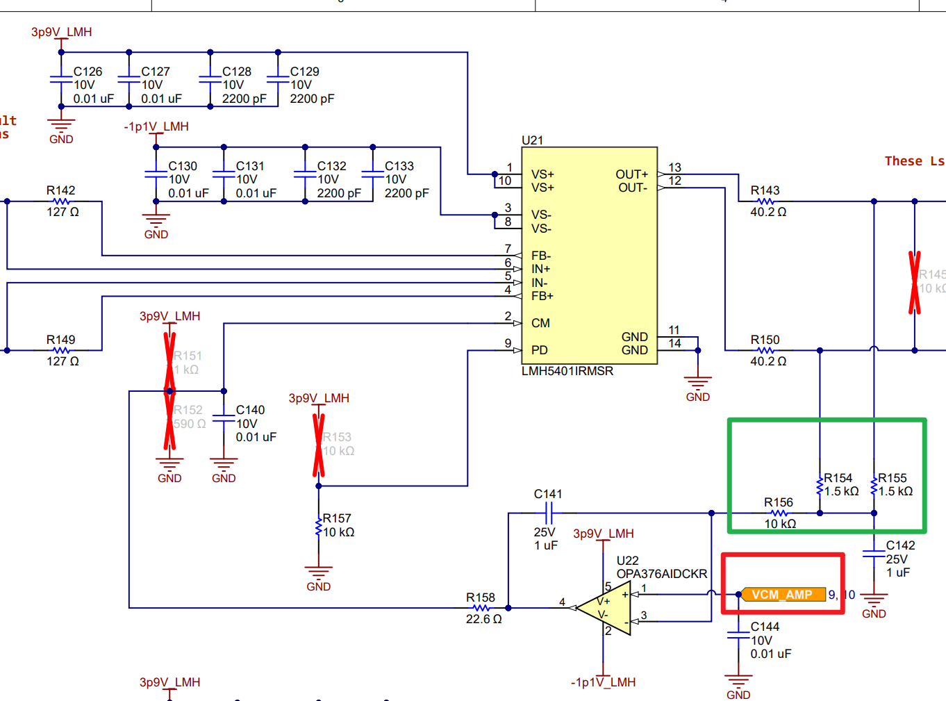

ADC3669EVM: ADC共模电压/ADC common-mode voltage
Part Number: ADC3669EVM
Other Parts Discussed in Thread: ADC3669, LMH5401, OPA376
绿框部分1.5K和10K电阻值是根据什么确定的?/How are the 1.5K and 10K resistor values in the green box determined?
红框部分连接了ADC3669的Vcm输出引脚(Pin21),这个是ADC内置的1.4V基准源吗?/The part in the red box is connected to the Vcm output pin (Pin 21) of the ADC3669. Is this the ADC's built-in 1.4V reference source?

  • 1. 可能原因如下:
    R154 // R155 = 750Ω → 提供低输出阻抗
    R156 = 10kΩ → 与ADC3669的VCM输出形成合理的驱动能力匹配
    OPA376作为缓冲器 → 隔离阻抗,提供低输出阻抗驱动LMH5401 CM引脚,5401的CM引脚阻抗比较高
    2. 内部1.4V
