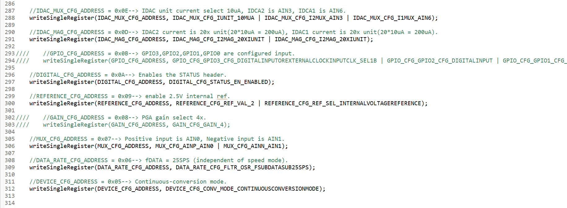

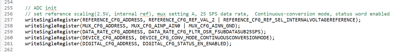

problem:The initialization using the DEMO program can communicate with the ADC. However, after modifying the initialization, I was unable to communicate with the ADC, and even when I used the DEMO program for initialization again, I still couldn't communicate with the ADC. Has the ADC failed?I need design a three-wire PT100 RTD measurement and two IDAC current source.Could you please help me analyze what caused this?
demo program:
my program:
