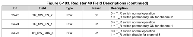

TX08D: About CWD transmit mode configuration
Part Number: TX08D
In Page53 of TX08D datasheet, It says 'By default, the T/R switch of all the channels are ON when CW mode is enabled and all the channels get configured in receive mode. To configure any channel in transmit mode, disable the T/R switch of corresponding channel using register bit TR_SW_DIS_n. ' But TX08D do not have bit TR_SW_DIS_8, Why missing TR_SW_DIS_8 in REG 40h of GBL_PULSER_PAGE ?
