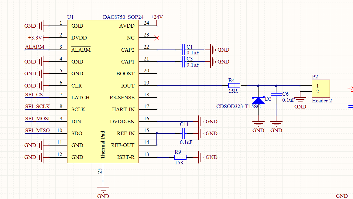

DAC8750输出的问题
Other Parts Discussed in Thread: DAC8750
原理图RT所示:
应该没啥问题,代码是按照网上成功的朋友写的:

void DAC8750_Config(void)
	DAC8750_Write(0x56,0x0001);					//复位所有寄存器;
	DAC8750_Write(0x55,0x100d);					//控制寄存器设置;  0001 0000 0000 1101
	DAC8750_Write(0x57,0x0000);					//配置寄存器设置;
//	DAC8750_Write(0x01,0xfdff);
	DAC8750_Write(0x01,0);						//输出0;
void DAC8750_Init(void)
	GPIO_InitTypeDef GPIO_InitStructure;
	RCC_APB2PeriphClockCmd(DAC8750_RCC, ENABLE);
	GPIO_InitStructure.GPIO_Pin = DAC8750_DIN | DAC8750_LAT | DAC8750_SCK;
	GPIO_InitStructure.GPIO_Mode = GPIO_Mode_Out_OD;
	GPIO_InitStructure.GPIO_Speed = GPIO_Speed_50MHz;
	GPIO_Init(DAC8750_GPIO,&GPIO_InitStructure);
	DAC8750_Config();
void DAC8750_Out(u16 data)
	DAC8750_Write(0x01,data);
但是现在没有电流输出?请问一下哪里有问题么?
REF-OUT引脚输出是5V
