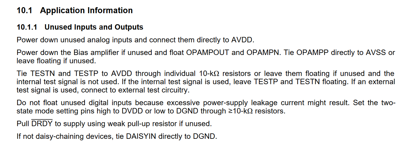

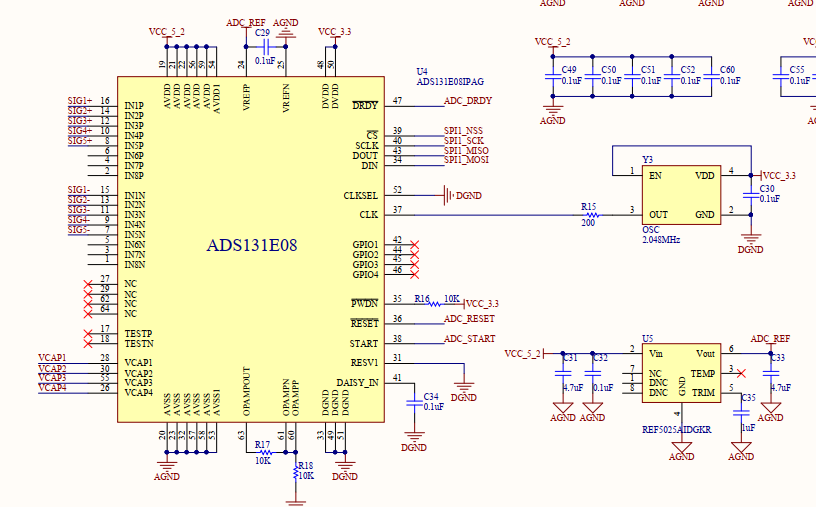

按照手册上配置好寄存器,但是读数为:
1c0=12813187,1c2= 1040895,1c3=16499137,1c4=12632256,1c5=12632256,1c6=12607584,1c7= 520447,1c8=16638176
1c0= 6293488,1c2=14737456,1c3= 3146744,1c4= 8388336,1c5= 7368728,1c6= 1573372,1c7= 4194168,1c8= 3684364
1c0=13639676,1c2= 393343,1c3= 1048558,1c4= 921091,1c5= 196671,1c6= 8912879,1c7= 460545,1c8= 8486943
1c0=12632079,1c2=12698048,1c3=12632256,1c4=12632160,1c5= 6293488,1c6=14737456,1c7= 3146744,1c8= 8368131
1c0=12611632,1c2= 4194232,1c3= 3673100,1c4= 65055,1c5=16768028,1c6= 1836544,1c7= 8326670,1c8= 921091
1c0=12586980,1c2= 459137,1c3= 8396739,1c4=16775043,1c5= 8618176,1c6=12586977,1c7=16776129,1c8=12697792
1c0=12607584,1c2=14737632,1c3= 6303747,1c4=16285695,1c5= 7368816,1c6= 1579009,1c7=16531455,1c8=12073016
1c0=14425094,1c2= 1048558,1c3= 921091,1c4= 196671,1c5= 8912647,1c6= 459521,1c7= 8396739,1c8=16776067
输入接地读数该为0,但是读出来的数一点不对,请各位大神帮忙查看一下哪有错误?!
