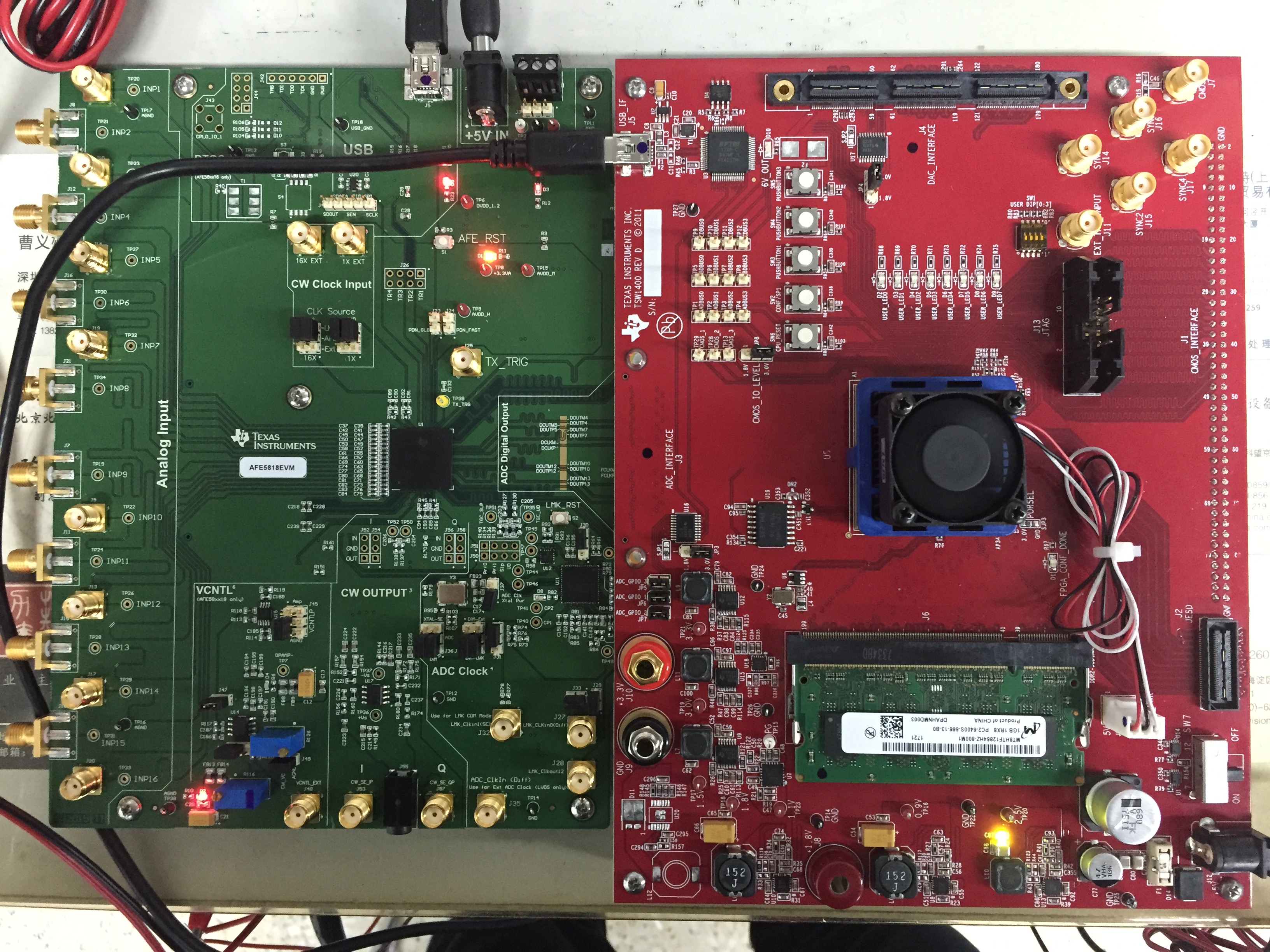

您好,我按照用户指南连接好了AFE5818EVM和TSW1400。
使用HSDCPro GUI 下载固件以后,TSW1400板子上的LED并没有如用户指南中所写的那样亮起来。等到HMC-DAQ GUI自动打开后,我点击“initialize Device”后,出现如下提示
点OK后,错误如下:
(Error 5001 occurred at Specified Register or Block cannot be find in Register map tree.
Source: Main Engine - Identify Register Details.vi
This error code is undefined. Undefined errors might occur for a number of reasons. For example, no one has provided a description for the code, or you might have wired a number that is not an error code to the error code input.
Additionally, undefined error codes might occur because the error relates to a third-party object, such as the operating system or ActiveX. For these third-party errors, you might be able to obtain a description of the error by searching the Web for the error code (5001) or for its hexadecimal representation (0x00001389).)
请问这该如何解决,谢谢!
  • This error code is undefined. Undefined errors might occur for a number of reasons. For example, no one has provided a description for the code, or you might have wired a number that is not an error code to the error code input.
    这里的说明是说软件和板子不匹配, 或者操作系统不支持
  • win10系统,已经按照用户指南进行了相关设置;软件HSDCPro GUI和HMC-DAQ GUI应该都是最新版本的。
