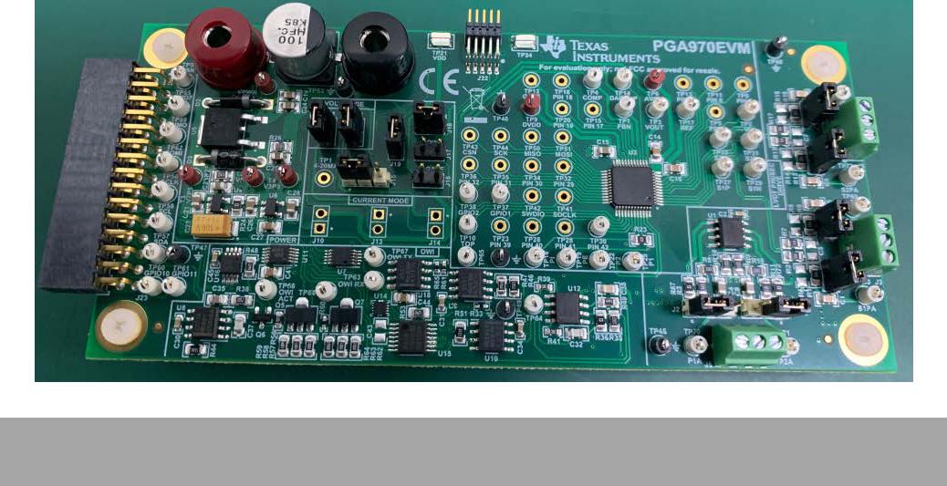

PGA970EVM 收到板子后不能工作
一、 外观检验(Appearance Inspection)
The appearance shall be free from deformation,oxidation,contamination,crack and
mark as required.

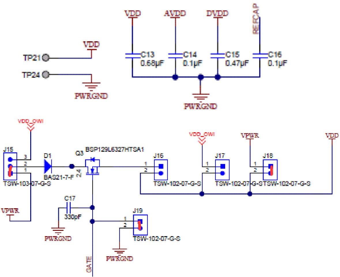

  1. Check the Default PGA970EVM Jumper Configuration was Normal:
Jumpers
Options
Jumpers
Options
J16
Open
J2
1 and 2
J17
Open
J7
1 and 2
J18
Closed
J11
Closed
J1
Closed
J12
Closed
J4
Closed
J19
Closed
J6
Closed
J9
Closed

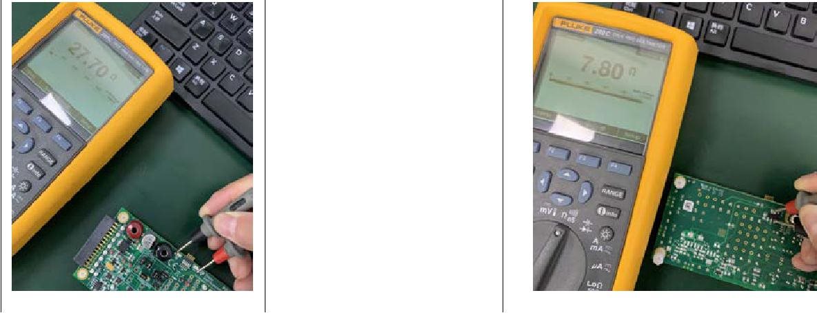

  1. Power ON The Multimeter and turn it to “Ω” Options
  1. Check the resistance like below:
Item
Normal Range
Test Value
Vdd and Gnd(TP21,TP24)
>100 ohm
27.7 ohm
C13
>100 ohm
25 ohm
Q3,2-4 and 3
Normal open
7.8 ohm
Table:1
Pass Condition:    The Normal resistance should be Like the table 1.
2.2     Test Capture:
Test Picture
VDD and   Gnd(Left)
Q3 Drain and Source
GND(Right)
三、 检验结果(Test Result):
After confirmation, the power supply of the product is abnormal and the
test result Fails.
四、 参考资料(Reference Data)
l  The PGA970EVM schematics:
