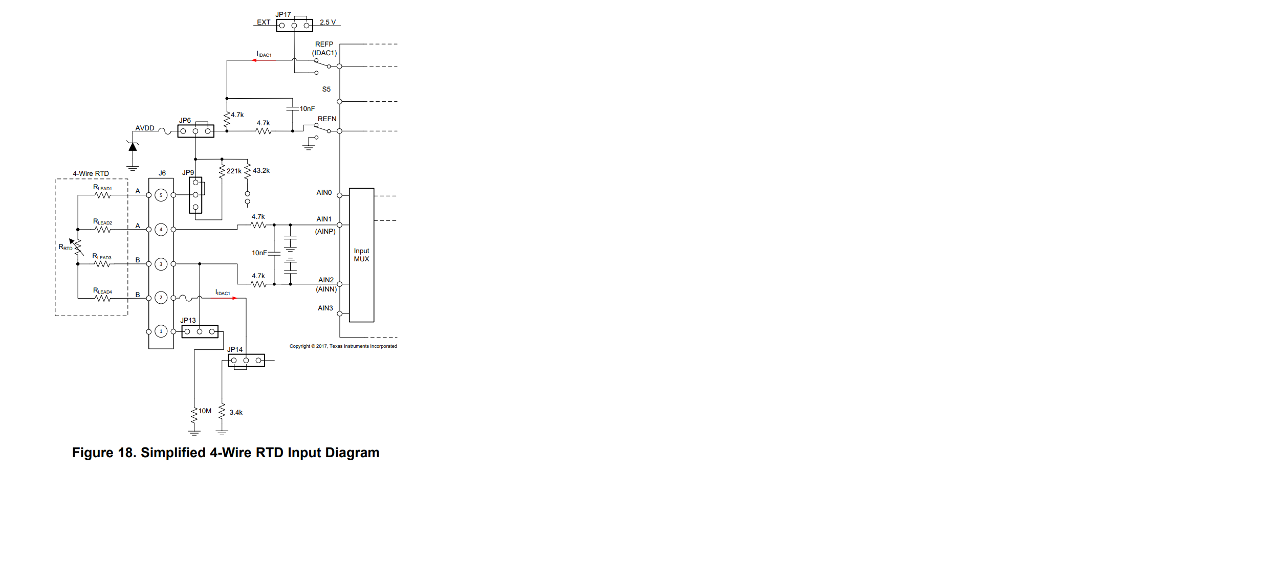

Hello, about the schematic of ADS122C04, you could refer to the EVM user's guide Page42.
www.ti.com.cn/.../sbau297.pdf
About the power supply, we recommend LDO, because battery is not used for a long time, the EVM recommend to use TPS71718 to provide the power supply.

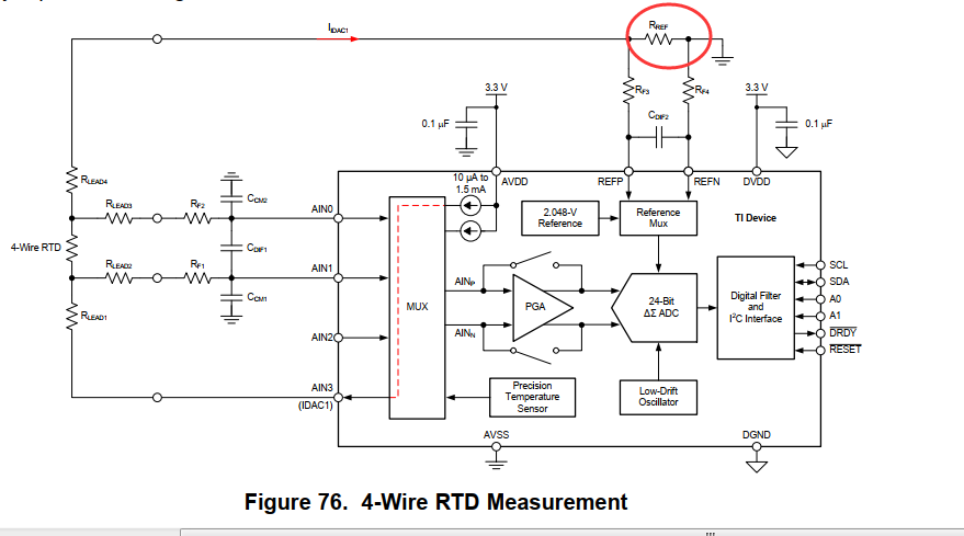

Hello, I have confirmed the circuit of ADS122C04, I didn't recommend the RESET pin connect the VCC_3.3V directly, it could connect the GPIO of MCU, because it need to meet the power up and down timing, that is to say, during power up, the RESET is from low to high, and during power down, the RESET is form high to low, it isn't always high, so it need to modify. As to the 4 wire RTD input and the external reference schematic, it has no problem, and the EVM user's guide has provided the detailed circuit, you could review again.
Thanks for your reply. I don't have enough pin to connect rest .I see the specs say so ‘ tie the RESET pin to DVDD if the RESET pin is not used ’.
OK,Thanks for your reply.There's one more thing I want to make sure.When using 4-Wire RTD, is the AIN2 pin to be NC?
Thanks for the reply, I was wondering which document your screenshot above is from.Can you release it to me?
