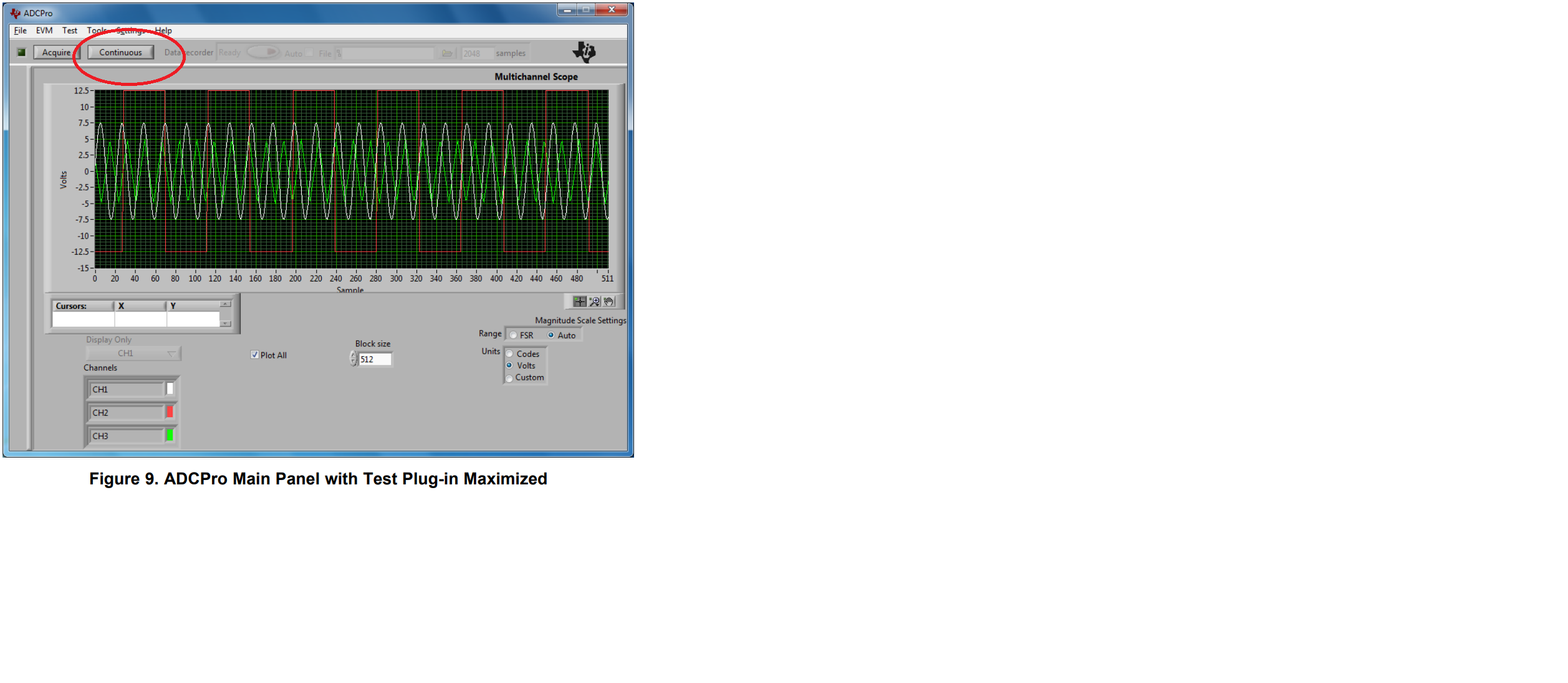

请问使用ADCPro怎样实现连续数据采集。现在只能设定Block Size
  • 您好,按照ADCPro user's guide中的介绍,  continuous 这个button应该就是连续采集模式:ADCPro can perform an analysis in either one-shot or continuous mode. In one-shot mode, the program collects a number of samples, analyzes them, and stops. In continuous mode, the one-shot operation is performed repeatedly.
    To perform continuous analysis, click the Continuous button (or the F6 function key)
  • 请问连续采集方式能否保存数据,我好像试了几次都不行。
