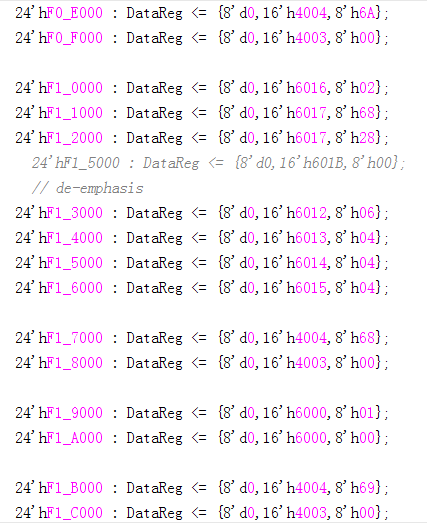

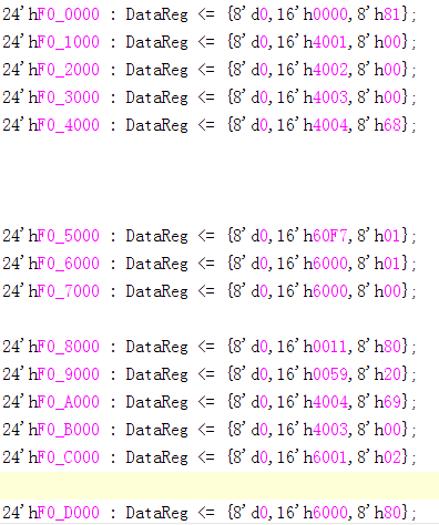

ADS54J60通过FMC与K7芯片连接,目前JESD204B已接通,通过ILA抓取PHY的数据有效位为高,同时JESD204B状态显示为数据被检测到:如下描述,采用4244模式,每个通道状态显示为eeee
Link Debug status Lane 0
Bit 3: 1 = Start of Data was Detected
Bit 2: 1 = Start of ILA was Detected
Bit 1: 1 = Lane has Code Group Sync
Bit 0: 1 = Lane is currently receiving K28.5's (BC alignment characters)
