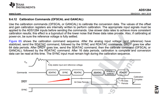

As the picture above, during the calibration procedure of ADS1284, what is the DRDY signal should be? Is there 64 rising edges to read the data or continuous high?

您好,
您是看的官网上的datasheet吗?看您截图中的章节与目前官网datasheet中的不一致,请查看官网最新版datasheet:https://www.ti.com.cn/product/cn/ADS1284?qgpn=ads1284
红色箭头所指的应该是64个数据,一个数据32bits,那么就是64*32个SCLK上升沿
