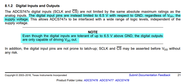

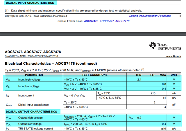

Part Number: ADCS7476
in datasheet discription, adcs7476 digital input voltage is independent with avdd,
is it mean that (digital input = 5V && AVDD = 3V ) or ( digital input = 3V && AVDD = 5V) allowed??
looking forward to your reply, thank you!
