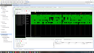

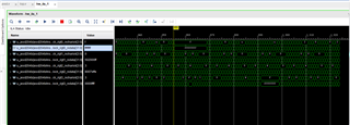

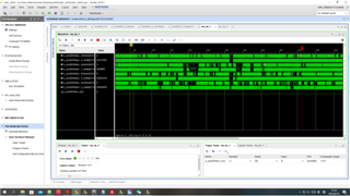

Hello, I use your ADCRF42 chip to support my own customized ZYNQ development board for high-speed data collection. At present, the problem is that the link cannot be established, the CGS state cannot be entered, and the BC code cannot be received on the FPGA end. I checked a lot of posts and still couldn't find the problem. Please help me!
The clock configuration is as follows:
ADC:Fs=750MHz SYSREF=1.171875MHz
FPGA:CORE CLK=187.5MHz reference clk=187.5MHz SYSREF=1.171875MHz
The clock's frequency and amplitude are generally fine

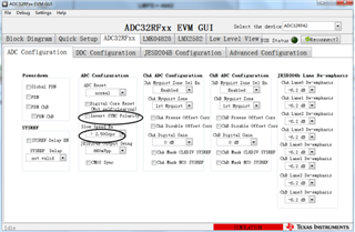

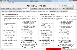

The AD configuration is as follows:
I used the GUI example Configuration file BYPASS ADC32RF42_4222 mode
The following two places have been modified
SYNC kept the level low and GTX did not receive K code from AD
