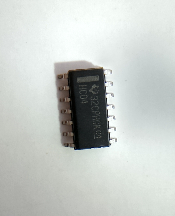

我现在手上有一个HC04芯片,他的第一行丝印是32CPHGK G4,其中G4有下划线,请问这是对应什么型号的HC04的啊?
The first line/row of the package marking is the Year Month (YM) date code.
The device names on the package can found at this web page: http://focus.ti.com/general/docs/partmarking/partmarkinghome.jsp
after entering the part number and selecting the "Device" button
Also see the package marking information at the web folder for the respective part found in the "Sample & Buy" table under the "Top Side Marking" column.
