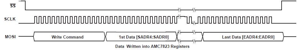

    For example, to read the register with address 0x00 on page 0, the host processor must send the AMC7823 the
    command 0x8000; this command specifies a read operation on page 0, address 0. After sending the command,
    the host reads one data word. To read the registers 0x02 to 0x07 on page 0 (ADC Data-2 to ADC Data-7), the
    host must send 0x8087 first, and then clock six data words sequentially out of the AMC7823. The first data word
    is from 0x02, the second from 0x03, and the sixth from 0x07. If the host continues clocking data out after reading
    the last location [EADR4:EADR0], the value 0x0000 is output until the operation stops. However, if the host
    deactivates SS before reading the last register, the operation is terminated and all remaining registers are
    ignored.

  • 我想知道GUI图形化界面是怎么初始化配置的,我看下我的思路是不是对的,时序是正确的我用示波器看了,发送的数据没啥问题,之后AMC没有反应

    请检查:
    1.AMC的片选引脚有没有保持置低
    2.在写寄存器之前,先要发送一个写指令,不知道Write_Cmd(ADD_AMC_config)这句话是否包含了写指令
    即,请确认在发送0x00A0之前有没有发送相应的write command

  • 你们这边有GUI对AMC的步骤不,就是发哪些命令的,顺序是怎么发的,Write_Cmd(ADD_AMC_config)这是对    #define ADD_AMC_config 0x128A   就是配置读这个寄存器,我看了时序是这么理解的,不知道你说的“请确认在发送0x00A0之前有没有发送相应的write command”这个是什么意思能否举个例子

    你在写Write_data(0x00A0);之前,先用SPI发送了0x128A,这就是我说的write command,那这个语句应该是没有问题的
    楼主可以检查下datasheet中提到的其他寄存器,看是不是漏了配置其中某个
