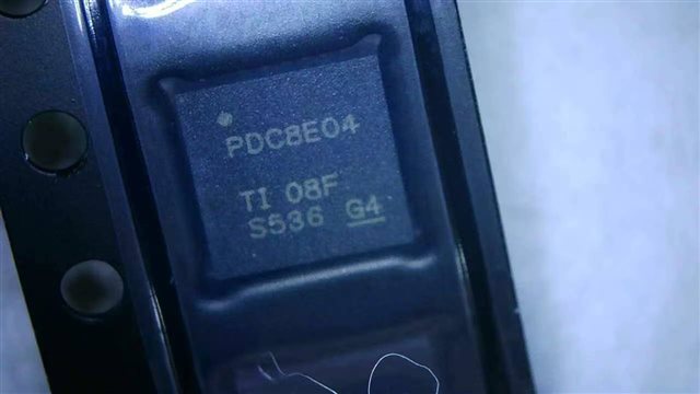

which TI part number of marking code is PDC8E04?
i can‘t find the marking code in https://www.ti.com/packaging/docs/partlookup.tsp
Hi zheng,
The part number is DAC81404RHBT.
It is looking likely that these units were incorrectly symbolized during manufacturing. The symbolization was used for our pre-RTM inventory, and was not correctly updated during during the product release. Our understanding was that any incorrectly symbolized material was removed from inventory, but it appears that is not the case. These units are still the DAC81404RHBT and are still covered by TIs standard terms and conditions. They are not compromised in quality.
