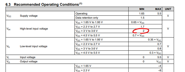

TIDA-010122: 原理图LMK04828_SYNC1和LMK04828_SYNC2电平是否有问题
Part Number: TIDA-010122
Other Parts Discussed in Thread: LMK04828,
Hi Team,
The voltage level of signals LMK04828_SYNC1 and LMK04828_SYNC2 from FMC connector is 1.8V level. But in this design,SN74LVC1G08DCKR use 3.3V power. Is it wrong?
Your guidance and insights into this matter would be greatly appreciated. Thank you for your time and assistance.
