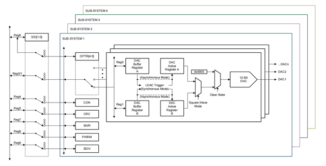

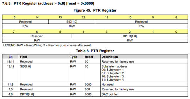

DAC60096: DAC60096寄存器
Part Number: DAC60096
 我在尝试驱动这个dac60096芯片,这写con、pwrm等是每一个子系统都有一份,还是说是全局寄存器,我现在尝试上电后去读取pwrm寄存器,并未得到任何说明书上正确的返回值,如果向ptr寄存器写入,再读取ptr会得到相同的值和其他值,不知是什么问题(I am trying to drive this dac60096 chip. Does each subsystem have a copy of con, pwrm, etc., or are they global registers? I am trying to read the pwrm register after powering on, but I don't get any correct return value as stated in the manual. If I write to the ptr register and then read ptr, I get the same value and other values. I don't know what the problem is.)
