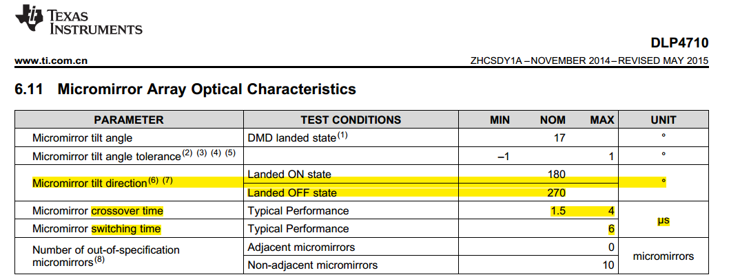

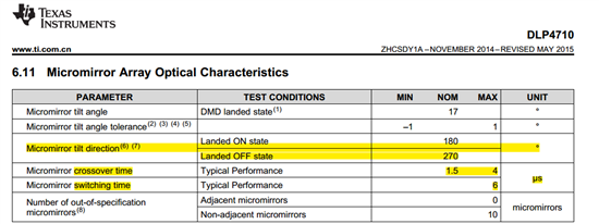

DLP4710 说明书里面提到的微镜倾斜角度是怎么定义的?180°(开启),270°(关闭)?这个角度怎么定义的呢?
  • 请参考规格书中的6、7项说明:
    (6) When the micromirror array is landed (not parked), the tilt direction of each individual micromirror is dictated by the binary contents of the CMOS memory cell associated with each individual micromirror. A binary value of 1 results in a micromirror landing in the ON State
    direction. A binary value of 0 results in a micromirror landing in the OFF State direction.
    (7) Micromirror tilt direction is measured as in a typical polar coordinate system: measuring counter-clockwise from a 0° reference which is aligned with the +X Cartesian axis.
