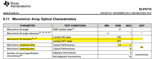

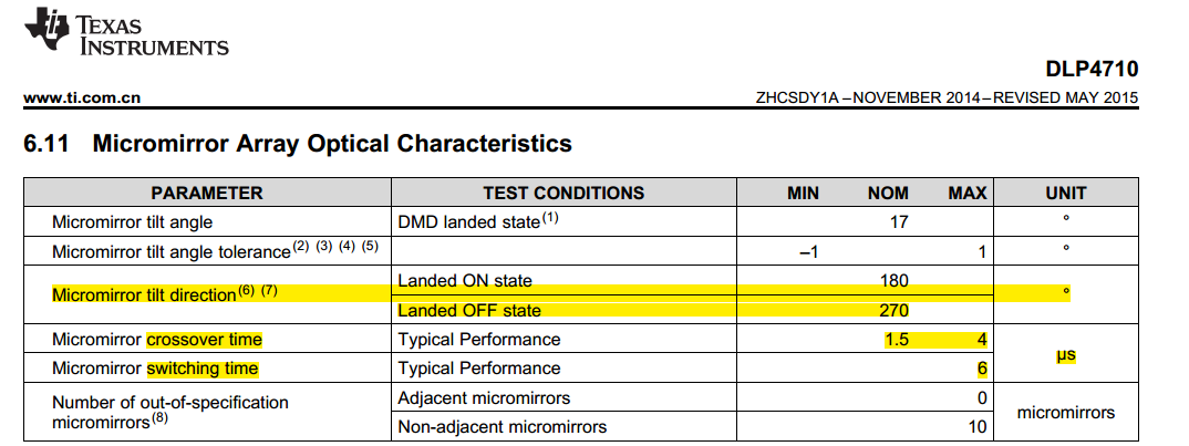

请参考规格书中的补充说明第8项:(8) The time required for a micromirror to nominally transition from one landed state to the opposite landed state.
