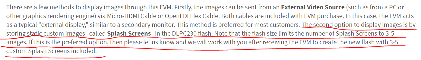

In the https://e2e.ti.com/support/dlp/f/94/t/934925,We can see that the engineer will help us convert the image to .bin format,is it ture?

Hi Preffy,
First of all, welcome to TI E2E forums.
What Ross mean here is he can built a new flash firmware which can have 3-5 customer splash screens. So what TI will provide to you is a new flash firmware(it will be .bin or .img), in the firmware it can include 3-5 splash images(Provided by you).
So if you already have a DLP5531Q1EVM, you can post a request on E2E and ask them to create a new firmware to you.
