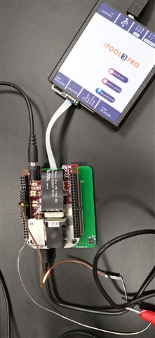

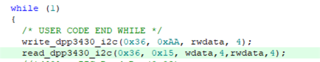

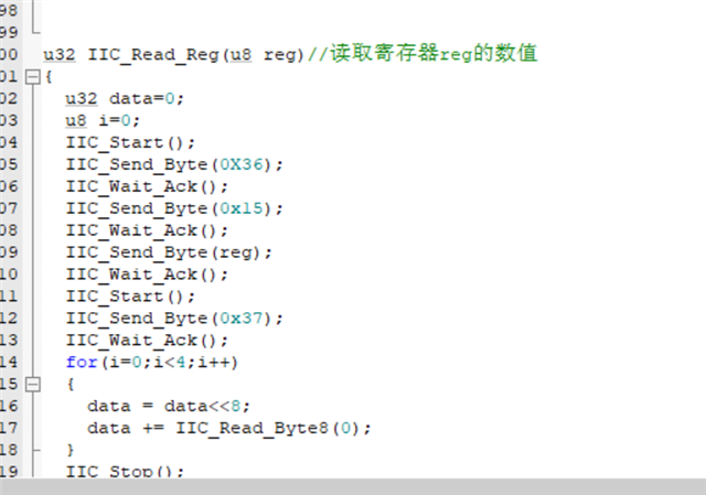

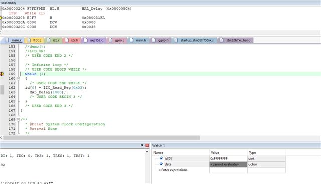

HI,I am a student studying DLP development. I use stm32h750 and dlp2000 for i2c communication, why can’t I read the register data?  IIC register (0x36 0x37).   the following pictures show the code. and the dubeg mode shows that the test register id[0]=0xFF,whatever id[0] is,the value is always 0xFF.

  • Thank you very much for your reply. But I still got some questions about your code. Could you please offer me a detailed reply?
    1、Since I used STM32H750, Will the different equipment we use change the usage of IIC?
    2、the "DLPC2607 Software Programmer's Guide" shows some register address and IIC commands , it seems to be different from yours.
    3、Could you please explain  in detail what each parameter in the functions is,the write_dpp3430_i2c() and read_dpp3430_i2c() [such as uint08 addr]
    4、Could you please show me the IIC address which you have used. is that 0x36 0x37 right? (I saw them from "DLPC2607 Software Programmer's Guide")
    Again, I‘'d like to express my warm thanks to you. Looking forward to your reply.
  • My purpose is to ask you to consider the I2C driver not  write_dpp3430_i2c() and read_dpp3430_i2c() API.
    I2C is the Philip interface standard. Your issue is not the I2C command, it is I2C driver.
    Please ignore the above DPP3430_I2C, which is for your timing reference.
