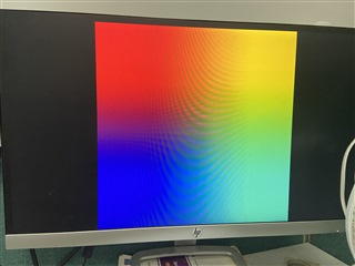

I want to control the device(DLPDLCR230NPEVM) with raspberry pi .After replacing  config.txt file with the sample config which downloaded from the official website ,the color screen is always displayed and cannot be turned on when restarting the raspberry pi. I wonder if it has anything to do with the model of raspberry pi while Raspberry pi 3B+ is now used.Or anything else?
  • For your case, first step you may want to verify if the DLPC230NP EVM board can still work independently. If things work okay, you may try with Rasperry Pi 4 which is compatible with DLPC230NP EVM out of box.
  •  I have verified   the DLPC230NP EVM board can  work independently as shown in the picture.And i changed for Rasperry Pi 4.But the problem  still exists.I followed the step in the user' guide.After  I modified the config file and restarted the raspberry pi, the raspberry pi could not start normally. I don't know what the problem is.Or there is anything wrong in my process?
